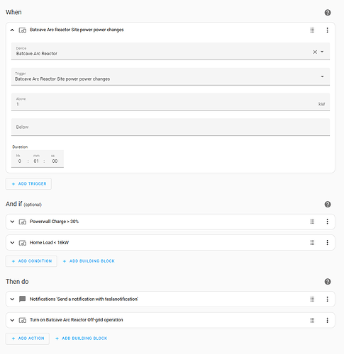

I just had my Tesla solar and 4x Powerwall system installed a few weeks ago. Until PTO, I am running in self-consumption mode without exports to the grid. Though my system is 23.49kW PV DC and 20.9kW AC, after solar generation reaches > 18kw, the system will begin dumping all excess not used by the house to the grid. I’m told by Tesla this will resolve once I have PTO. To prevent this, I have been switching the system to Off-Grid Mode a bit before peak production each day if its sunny and getting up there. I decided to try to automate this and I think I got it! As of now, here is the automation:
Another simple automation turns it off at 2pm when I’m well past the point of peak generation and certainly below 18kW generation. Just set this up this morning. Excited to see how it works.
Note: As I wrote this I realized I probably could just tell it to turn off the grid once production got to around 17kW and then enable the grid once production was below 15kW for over 30 minutes or something like that. I’ll try it this way first.
Created another automation to stop pulling from the grid by setting off-grid to on if the battery is at least 30% charged and home is not pulling more than 16kW.

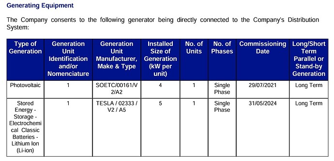

Providing the Powerwall Operational Mode is “Time-Based Control”, and the Powerwall export limit has been set according to the DNO approved amount, in the Tesla app > Settings > Powerwall you should see “Energy Exports” with an option for Everything. If not, your export limit has likely not been set correctly and you will need to contact your installer, or Tesla, with the DNO letter for them to set it.
As Mark says, if you don’t have the Energy Exports option then you may not be allowed to export by the DNO (or other electricity authority if you’re not in the UK) - in our case we’re allowed to export from our solar up to the 16A statuatory limit but are not allowed to export from the Powerwalls.
Thanks both, so although I get the option through the custom integration on HA, I cannot see it on the Tesla app. So I need to contact them.
Looking at my DNO, I do not see anything that specifically says I’m not allowed to export, but perhaps it would say that I am, if I were.
I will be very annoyed if I cannot, because they denied me a second battery, so I assumed they were happy with 5kW export, but not 10kW.
C’est la vie !
I have two Tesla Powerwall 2 (5kW discharge each) and a 3.68 inverter, so a theoretical 13.68kw total export. However the G99 application response from the DNO approved only 8.68kW total (note the text “5.0kW (zero export) battery”). I contacted Tesla and gave them this response they remotely configured the Home Backup gateway to limit export to this 8.68.
Okay, so from mine, I get the impression I need to look up the Tesla phone number :slight_smile:

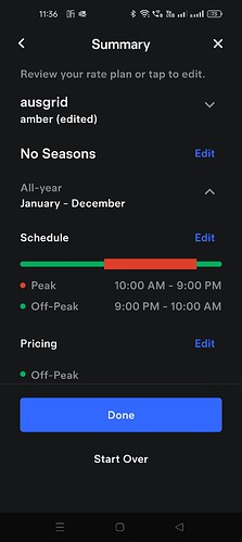

@pjvenda Read all your threads again. And understand what you are doing. Thanks a lot for your effects. I am in Australia and have Tesla Powerwall battery and using Amber as power supplier. Amber has it own app to control tesla powerwall battery and ask all tesla user to set mode as self powered all the time. I test a few functions for Tesla custom integration, And find Export mode doesn’t work anymore in my case, no matter it is on “solar” or “everything”. In Tesla App I did setup a schedule to put very high feedin price as 1.00. Still not doing anything if even in TOU mode, when flip solar to everything.
Any idea?
It can take a couple of minutes for the Powerwall to react.
Did you resolve this? I’m now finding the same problem, although I was able to export some time ago.
For anyone with the same problem, I created the Utility Rate Plan from scratch, and it is now exporting. Off Peak: 0.08 IN, 0.15 Export; Peak: 0.29 IN, 1.15 Export.
