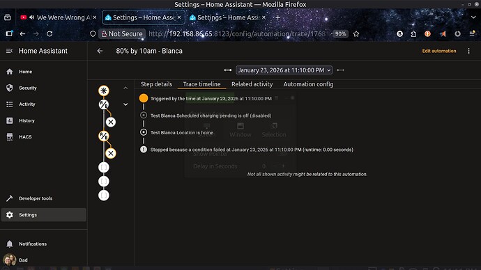

When I call the location API from the Tessie integration, the automation fails. I’m not sure if this is a Tessie issue or a HA issue because it was working until recently (2026.x builds). Tessie is currently in debug mode until this is resolved. All Tessie permissions are enabled on Tessie website, including location. When I enable the location call in the automations, the automation stops and I get an error via traces:
Condition failed?? It seems as though Tessie is not providing the location data when requested and therefore the automation fails. However, if I disable the location call, the automation (see below) finishes without error.

    enabled: false  #<-----This was disabled for troubleshooting. Fails if set to true
