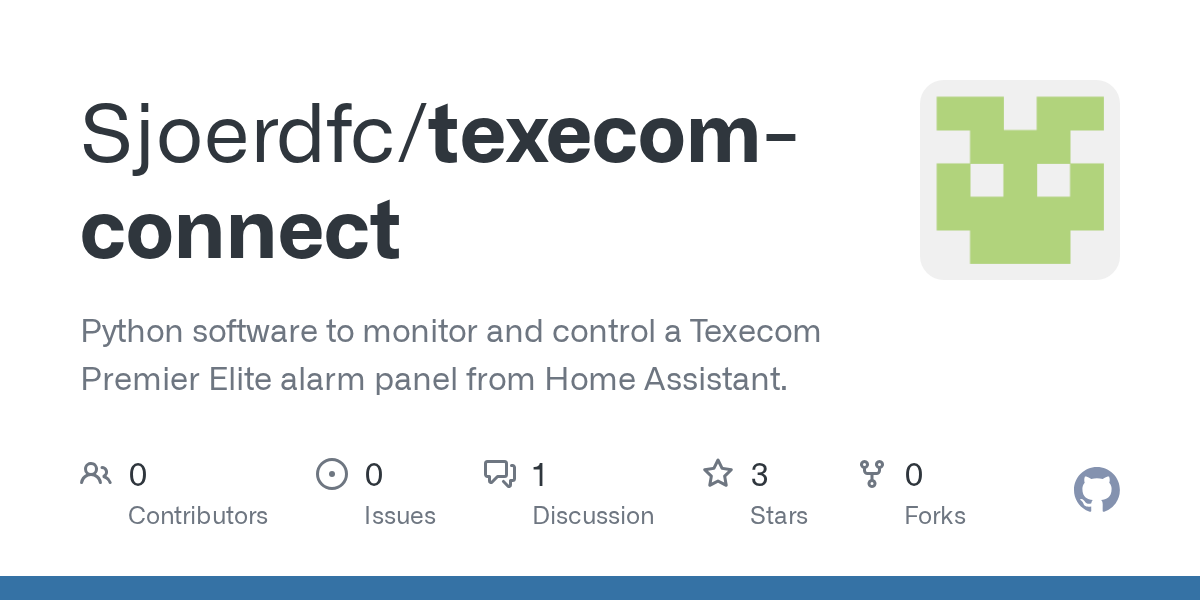

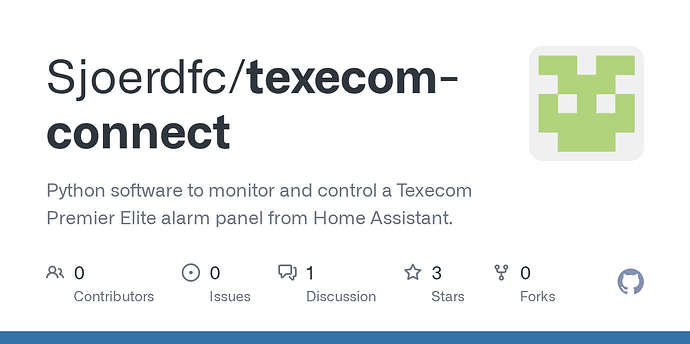

I forked the davidMbrooke texecom-connect python script a while ago, and created a Home Assistant addon from it. It works pretty good for me.
