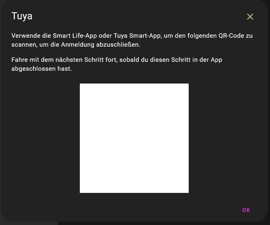

Hi there, I have a new similar issue when using barcode in Tuya integration. I only see white barcode on white background, so no barcode visible. In standard theme it is visible. I found out, that the barcode seems to follow the “primary-text-color”, but I want to use white for that. So what is the theme-entry for the barcode background?

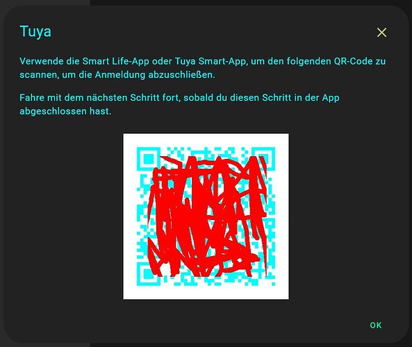

When change “primary-text-color” to blue:
