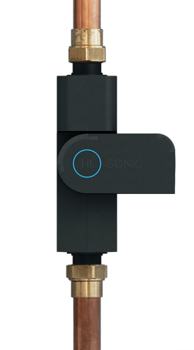

Hi John - thanks for the reply.
I hadn’t seen the Phyn or the Grohe, but did have a look at SONIC by HERO and the Flo devices. All of them are quite pricey and some have an app - cloud based - meaning at risk of the service being removed, or changed to charge money in the future (or already charging). I am also concerned with fitting one as they are all non-UK devices - will they fit a UK pipe? Will I need to add an adapter which may reduce the flow in the house and would this diameter change to the pipe make the device inaccurate for usage measurements?
My annual water bill is about £500 - so spending £700 + (monthly) service fee isn’t worth it for me to know how much water is used when I flush the loo : :woozy_face:
The auto-shut off is a game changer (as you point out) and could make it worth-while for some.
It did for me, I already have an automatic cut-off valve (not unlike the leaksafe you mention). Its been in place for 15 years (and was expensive “but worth it” back then) - its an autostopcock: https://www.autostopcock.co.uk/. It definitely works - a running toilet (or badly closed tap) after 15 minutes will cut off all water to the house. It’s simple and it works - great device, just not smart. I see they do a “Plus” version which includes flow now - but that’s over £700… I might have been a little ahead of the curve when I installed it :slight_smile:
So I’m not really concerned with flood/auto water cut-off - just the measuring of use in quasi real-time. Delayed metering just does not allow for making a connection between what is non-essential use vs required use. I can’t remember what I had for breakfast, let alone how and why I used water three days ago! Measuring flow in real time means I can set an alarm to say “hey you’re using a lot of water now” and maybe think twice about it - or know that my 15 min setting for garden irrigation uses 200+ litres of water a day, when I only really need 30 - or how many times a year do I really need to jet-wash the garden.

The Sonic, Grohe and Leaksafe are definitely available in the UK and will fit UK pipes. The Phyn should become available in the UK via Belkin but I don’t think this is true yet.
If they are in the UK then they should be compatible. Most of them look good and will do the job, so I am sure those without auto-water shutoff will find the most value there (with the nice side-effect of getting water usage info, too).
