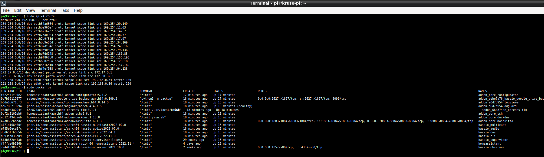

  1. With my current state if I disable home assistant completely and reboot, at the debian command prompt I can ping google.com with no issue and get a very fast response - until I pull the ethernet plug and put is back in again - then the internet access is gone. Same issue with HA running - so no change in symptoms. That was when my RPI had this status below:
  2. I had since our discussion updated this to read as shown (I was trying to put them back to the default values - do you know what those are?):
  1. and this is some possibly useful info:
  2. But lastly, I did originally follow the steps from the nabu casa site on how to set up HA Supervised, but I might have actually dones one or more of the steps after your suggestion for steps 2.1 on - possible as root…
So, if ultimately unable to get the RPI to be ablke to reconnect after a connection is lost - I may just blow everything away and install from scratch again. Maybe however this time if I have to do that I will during the install - stop just before step 2.1 when the plain OS is there and see if I can disconnect and reconnect the ethernet to see if it recovers - before rebooting and then contrinuing with the install. If it in fact does not reconnect when the ethernet cable is plugged back in without even HA installed - then I have a different issue - ugh!
(Maybe in case you cannot see the big picrture above clearly):
