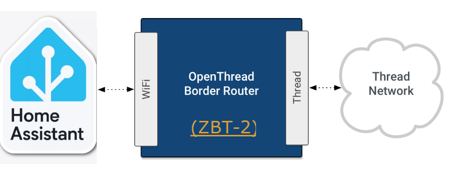

I know that the Thread standard/protocol support using multiple Thread Border Router (TBR) as entry/exit points for a single Thread network, but as I understand this is not yet supported with ZBT-2 nor with the built-in OpenThread Border Router (OTBR) add-on/integration in Home Assistant, or does it support that already?
I think that the OpenThread Border Router (OTBR) add-on/integration is currenty limited in this regard so today it can only connect to a single Thread Border Router, or am I wrong?
…I bet that if it supported multiple Thread Border Router then they sell a lot more of ZBT-2 as the more Thread Border Router devices your network have the more stable and robust it will be! :wink:
I believe to achieve that Home Assistant developers would both need to add support to connect multiple OpenThread Border Routers to the OpenThread Border Router (OTBR) add-on/integration, and ESPHome firmware developers probably also need to enable Wi-Fi support on the ESP32 in the ZBT-2 so that it can act a LAN-proxy to allow connecting remotley to the OpenThread RCP firmware.
The architecture would look something like this:
  • Home Assistant’s OTBR add-on/integration ↔ LAN ↔ ESP32 proxy ↔ OpenThread RCP.
