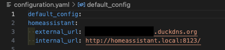

The picture you posted in #7 looks like you are using an URL for the internal site that does not contain duckdns.org, which makes the certificate invalid, so when you at the same time use https for the internal site, then it will fail.
