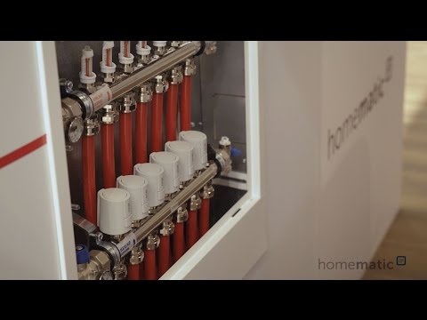

ah that’s good. For underfloor heating, you can consider Underfloor heating controller – 12-channel, motorised | Homematic IP too. Didn’t use it myself. But I suggested it at my parents place, but they aren’t so into all the smart stuff.
Also featured in this video:
They do have TRVs as well, btw: Radiator thermostat – Evo | Homematic IP
If I am right Homematic can run local (without cloud), which would make it a durable choice for the future.
