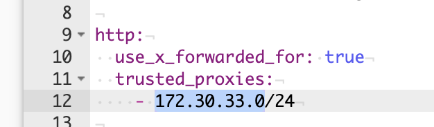

I have been using a cloudflare tunnel with the cloudflared app running in the background. I was under the impression that I needed to set use_x_forwarded_for and trusted_proxies for all of the cloudflare IP ranges in order to access through the tunnel properly.
I want to remove this deprecation, but I don’t see any options in Settings > System > Network for the reverse proxy configuration.

You need to remove the http: from your configuration.yaml, and then enter the Reverse proxy in Settings > System > Network > HTTP server.
The settings should have been auto-migrated, the were for all of the HA systems I run. The issue is that a lot of the system dashboards have long TTL caches so you have to force refresh them to see the new additions.
ahh that did it, it was a cache issue. Thanks!
