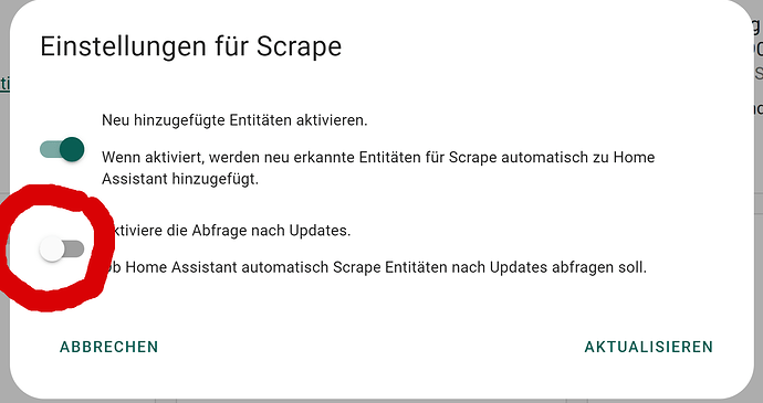

It seems as if the sensors you set in the GUI are auto-updating every 10 minutes.
If you need more/less frequent updates, you can disable the auto-update in the system options for each sensor. Then you have to add an automation to update them at your chosen time interval (or any other trigger).

Did you disable the automatic update (in the GUI) for the affected sensor?
Well - thinking about my comment - that would only apply to a sensor configured via the GUI.
So I take it, you configured a sensor in the configuration.yaml with a scan_interval of less than 10 min and it doesn’t do it?
