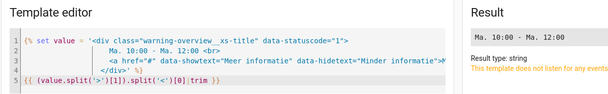

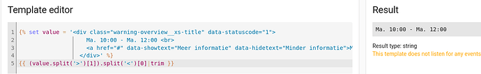

Who can help me out, my scrape gives me to much information that i want to clean.
I only need the text line with the time but i can’t figure out how to clean up the results and remove the url.
<div class="warning-overview__xs-title" data-statuscode="1">
                    Ma. 10:00 - Ma. 12:00 <br>
                    <a href="#" data-showtext="Meer informatie" data-hidetext="Minder informatie">Meer informatie</a>
                  </div>
value_template: "{{ (value.split('>')[1]).split('<')[0]|trim }}"
Thanks, feeling realy stupid now. :slight_smile:
