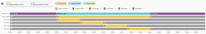

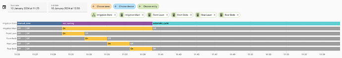

@Didgeridrew @TheFes @petro thank you for all your help and clarifications, and I need to apologise, because I certainly stuffed something up during my testing. I think I deployed the code I posted initially, but never reloaded/restarted (I can write a long story as an explanation, but basically it involves a baby and the lack of sleep). :smiley:
Without making any changes, I simply reran it and got the incorrect results:
I opted for a version using trigger variables instead, which fulfills all of my goals.
