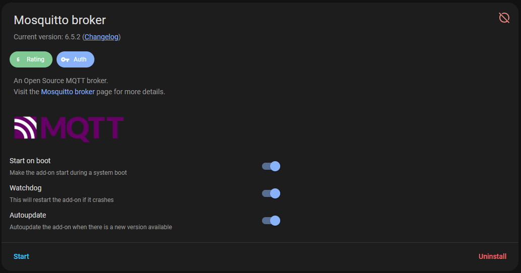

I’m facing the same issue. After Supervisor 2025.11.2 update, at least visually no addon is or can be started. For example, Mosquitto Broker (post HA reboot, should start on boot):
If I try to start it, the Supervisor logs say that it’s already running:
2025-11-15 22:40:10.414 WARNING (MainThread) [supervisor.addons.addon] core_mosquitto is already running!
And I can actually connect to it so yeah, it’s running. I believe that indicates that the issue is not related to the addons themselves, as the behavior is the same for all. I didn’t see any warnings for deprecated fields on my side.
