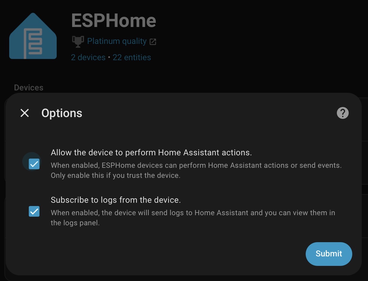

I had this same issue. Got the Voice Assistant joined to WiFi and appearing in Home Assistant, and the setup process failed with the message “ The voice assistant is unable to connect to Home Assistant”. After trying many things, the solution for me was to tick the boxes in the ESPHome integration, hidden behind the gear icon for the Home Assistant Voice. These were unchecked by default for me. I think the one that did the trick was “Allow the device to perform Home Assistant actions. When enabled, ESPHome devices can perform Home Assistant actions or send events. Only enable this if you trust the device“
