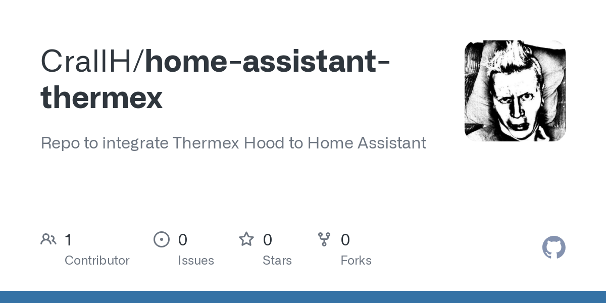

So I got the manual from thermex.
Unfortunately I’m not a developer so I had to cheat and use AI :disappointed: (I know that not how an integration should be done).
I took @hsk-dk repo and the manual from thermex and asked chatgpt to help me update it (hsk-dks integration flooded my log with messages) to home assistants standards and to add UI setup for the integration and to be hacs compatible.
So here is my repo for Thermex hoods with a blueprint for automations and UI setup.
