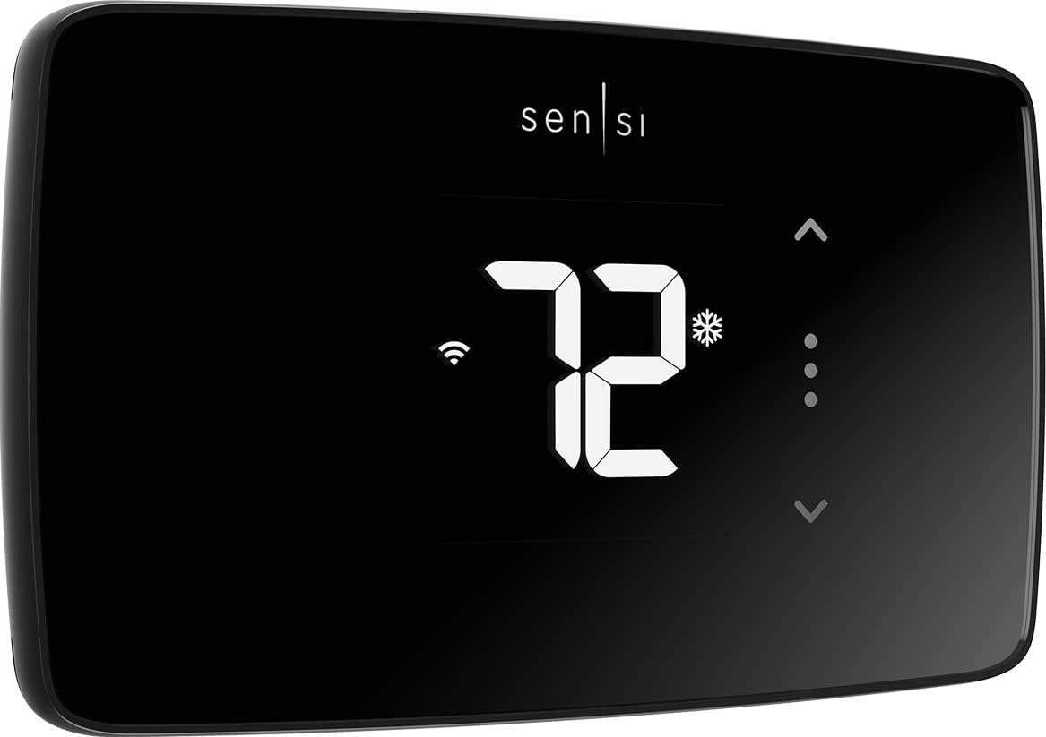

I’ve had good luck with one similar to this that I got at a charity shop. (for $10)
Thank you for your input. I will buy this and give it a try! :grinning:

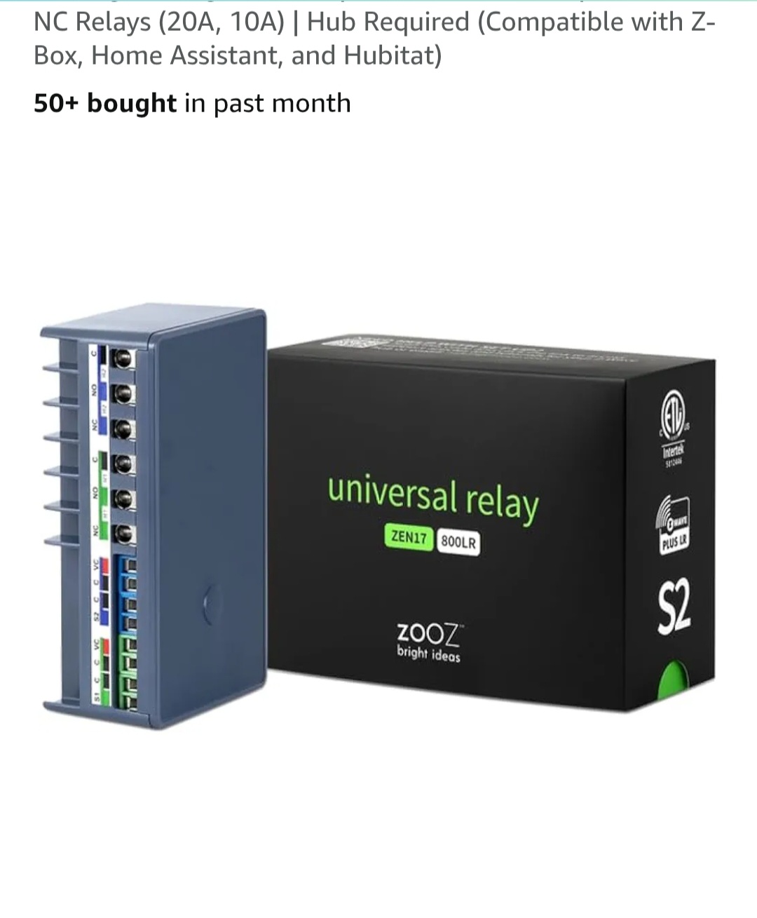

Thank you for that. I just looked and it does have a spot for 4 wires, i will look in the manual and I’m sure its for a dry relay. I will have to figure out the generic thermostat part out in HA. That being said, is there a easy way to start to make the thermostat in HA?? you’ve been a huge help.
Generic thermostat in HA is supereasy.Look for helpers(settings,integrations,helpers)
So I’ve got this relay and the temp sensor. If i understand correctly i could use both of them and just create a generic thermostat and I would be set??
yes,just like that
