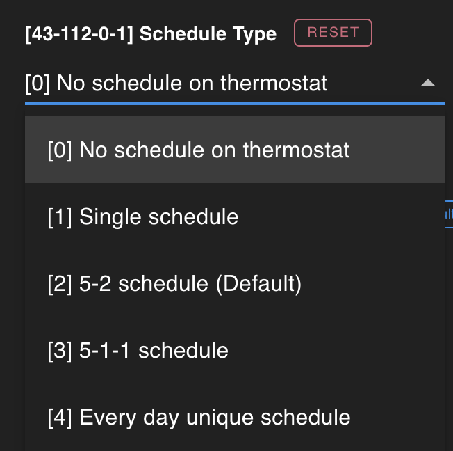

Do you have a screen shot similar to Busman please?
Nope. Just repeating that the thermostat expects to have z-wave control it when it’s included in a z-wave network.
HA can turn it on or off.
Just to be clear, I have 2 of these in Home Assistant and have never had “issues”. I can control them as expected and they update Home Assistant as expected. What exactly are you referring to?
