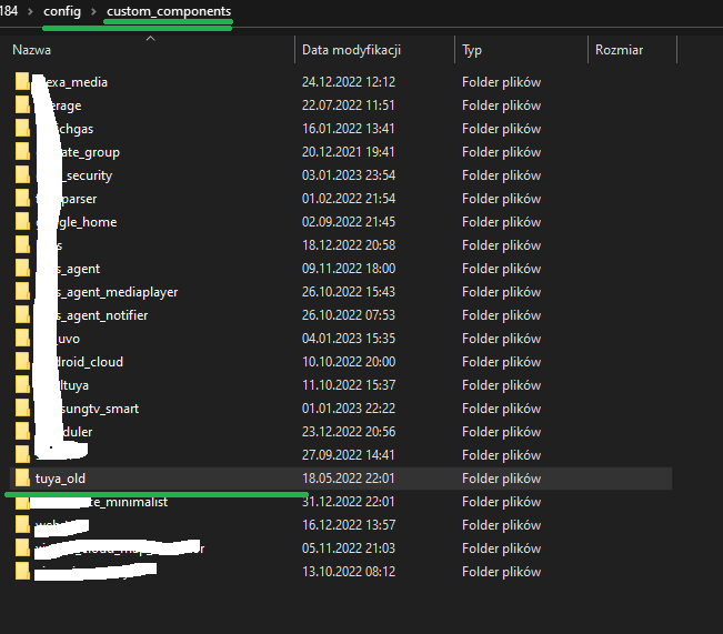

Copy folder home-assistant-tuya-old/custom_components at main · andrey-yantsen/home-assistant-tuya-old · GitHub
Pase folder to folder custom_components - tuya_old
ScreenShot_20230104175908
Restart HA

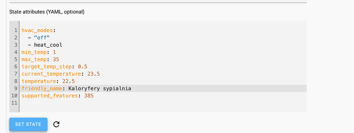

I tried to change state attributes of the device in Developer’s Tools:
where I can set up displayed values however after the thermostat is switched on HA immediately displays wrong values (proper values divided by 5)…
