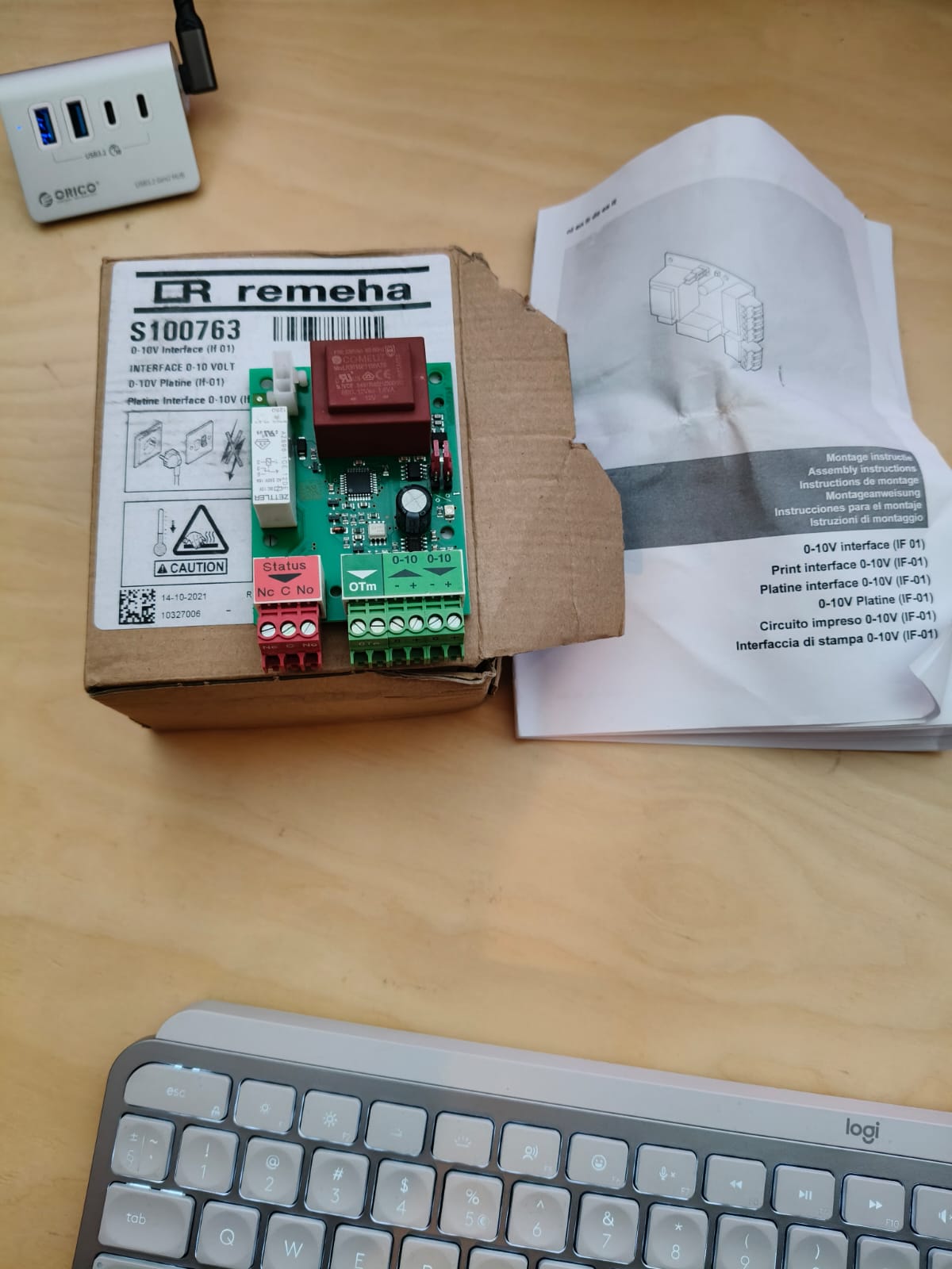

I have also been looking for an opentherm module/thermostat for some time now, there are 0-10V to OT modules available from Remeha (can be used for any OT boiler), now I am looking for a physical room thermostat (Z2MQTT) or a virtual HA thermostat and then a 0-10V output module. Has anyone already tinkered with this or is there already a script somewhere?
