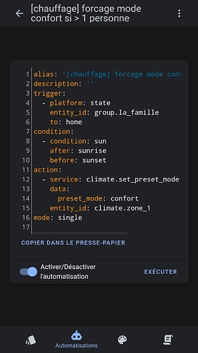

Je n’arrive pas créer les automatisations
Quelq’un pourrait il m’aider ?
M
Your condition needs to be before sunrise OR after sunset, it is not possible to be both at the same time.
This is clearly detailed in the documentation for conditions.
Ok :ok_hand:
Mais le problème est que je n’arrive pas à lancer le service pour passer en éco ou en confort avec l outil de développement
M
Because the invalid condition prevents the automation from executing the action.
Replace the condition with the following:
condition:
  - condition: state
    entity_id: sun.sun
    state: above_horizon
Also entity_id may need moving to the right 2 spaces, I have a fuzzy memory of some services not accepting the entity_id key outside the data key if the latter is present and I think this is one of those inconsistencies, but I may be wrong.
