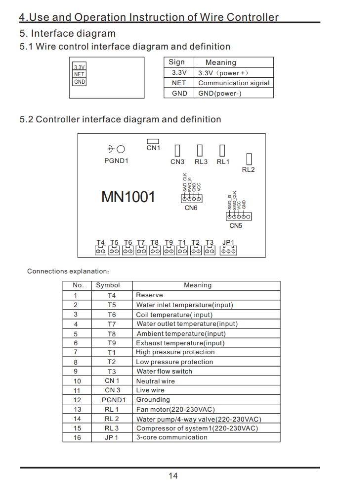

There are also control board schematics in the manual, with simple connections for temperature, flow, and mode settings, so worst case it looks like dropping an ESP32 in there is a viable fallback option.

I’ve just got one of these, it has a PDF on their website showing the bluetooth “wire controller” connection, can’t find any info on the NET protocol though
