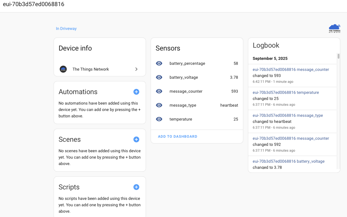

I’m trying to setup the HA integration w/ Things Network v3.
The issue I’m running into is that one of the entities is missing, i.e. door_open
(which should be of boolean type).
Here is the decoded payload in TTN:
The value of door_open
is always either true
or false
But I don’t see that one in the list of entities in the integration. (I see all the other items though.) So I’m confused as to why it’s not showing up.
I did turn on debug logging for the Things Network integration, and I did find this in the logs:
2025-09-05 18:37:11.949 DEBUG (MainThread) [homeassistant.components.thethingsnetwork.coordinator] fetched data: {'eui-70b3d57ed0068816': {'battery_percentage': TTN_Value(58), 'battery_voltage': TTN_Value(3.78), 'door_open': TTN_Value(False), 'message_counter': TTN_Value(592), 'message_type': TTN_Value(heartbeat), 'temperature': TTN_Value(25)}}
But door_open still does not show up in the entity list. I’m not sure where to go next…

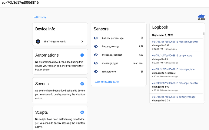

Ok after a bit of playing around, this appears to be an issue where boolean sensors are not detected or created by the integration.
I see the integration code handles ttn_client.TTNSensorValue,
"""The Things Network's integration sensors."""
import logging
from ttn_client import TTNSensorValue
from homeassistant.components.sensor import SensorEntity
from homeassistant.config_entries import ConfigEntry
from homeassistant.core import HomeAssistant
from homeassistant.helpers.entity_platform import AddConfigEntryEntitiesCallback
from homeassistant.helpers.typing import StateType
from .const import CONF_APP_ID, DOMAIN
from .entity import TTNEntity
but this class only handles types of string, int, or float.
There is a separate ttn_client.TTNBinarySensorValue which handles boolean.
But this does not appear to be handled by the things network integration.
I’m not sure why there is a separate ttn client sensor type.
