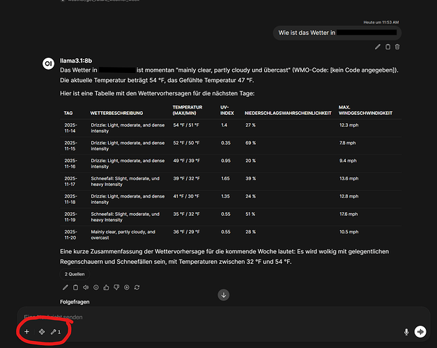

Seems to work in OpenWebUI (I downloaded the “weather”-tool).
I also tried the OpenWebUI to HA (it is called home_assistant) tool in OpenWebUI. It was able to see my whole HA, which means it used the tool. Same as the weather, which is correctly displayed and searched online.
