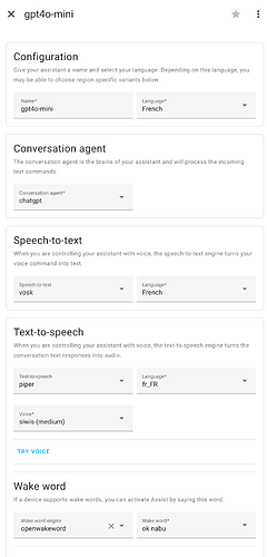

This while I do have two assistants configured :
and properly configured :

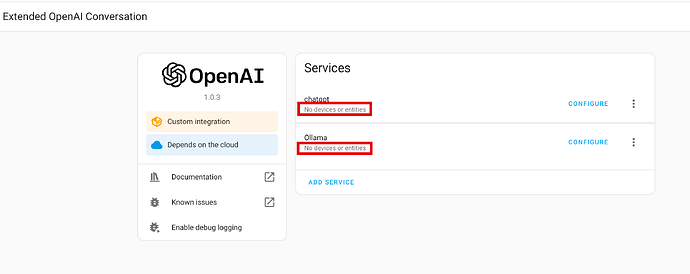

I did not check my extended openAI integration settings, and indeed :
Still, it is weird it works with absolutely no issue on mobile clients (ios here) and when using an atom echo device as input.

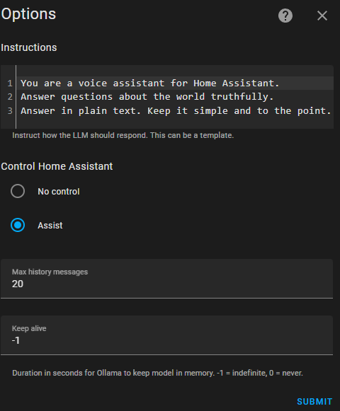

Hey, just wanted to come and put my first comment in here as I just got local Llama3.1 model running.
I had to go to the settings of the model and enable assist.
It doesn’t work with all my requests, but seemed to work atleast controlling the office lights.
