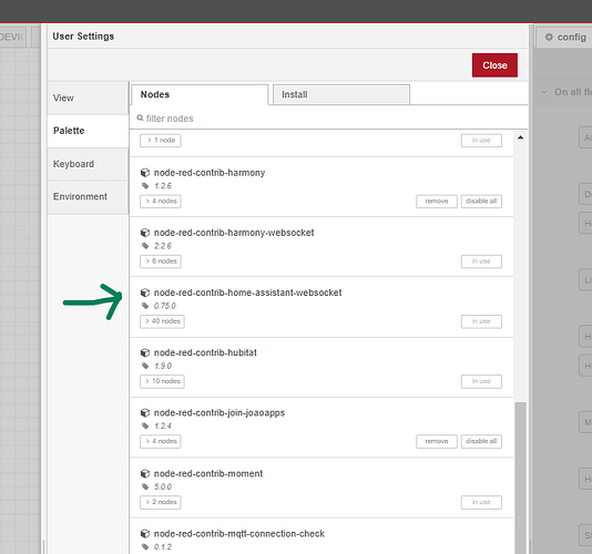

It looks like you don’t have Home Asssistant palette loaded into Node Red. I use Node Red outside of Home Assistant so I don’t know if Node Red Add-on automatically loads the Home Assistant palette. I had to add Home Assistant’s palette: node-red-contrib-home-assistant-websocket

I don’t see a specific mention that the Home Assistant palette is automatically installed for add-on but you would think it would be. Goto Hamburger menu at top right of screen in Node Red then Manage Palette.
Look under Nodes for node-red-contrib-home-assistant-websocket
Again, I am giving advice from point of view of using Node Red on it’s own, not as a Home Assistant add-on. I tried to install the Add-on to see. Clicking start never does anything for me.
I had SSL checked so it wouldn’t install. Fixed that so now I got the Node Red Add-on running and it does indeed have the Home Assistant palette installed. I am afraid that I am at the limit of my knowledge on this. Sorry. A ton of people use Node Red; I am surprised no one else has commented.
