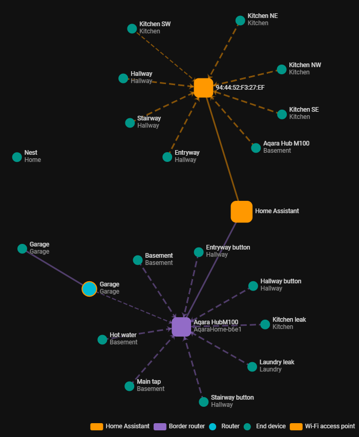

I use the Aqara M100 with my IKEA thread devices (GRILLPLATS Plug, MYGGBETT door/window sensors, BILRESA dual buttons and KLIPPBOK water leak sensors). It is the cheapest TBR I could find and has given me no problems. It is a simple TBR<>WIFI bridge - that meant I could place it in an optimal spot in the house (which in my case was nowhere near the Home Assistant server). It is USB-powered (only connected through WIFI though).
