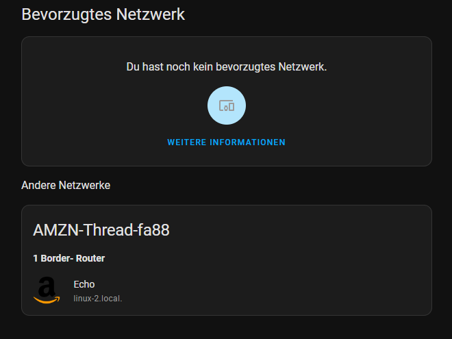

I have a Matter over Thread device. A connection to HA is only possible with a border Router. This Matter over Thread device is connect with my Amazon Echo4. The Border Router from my Echo is running.
And i see this Border Router in my Home Assitant. But only under other networks

No, because i need a thread border Router. Matter over thread and Matter over wifi is not the same.
The device is connected over Matter Thread with Alexa. Alexa is the Thread border router. But i can´t set this border Router in Home Assiatnt to my preffered network.

What are you referring to here exactly? If you use our OpenThread Border Router, then yes, you need to have the credentials in Home Assistant and sync it to the phones.
However, you try to use a third party border router. In that case the credentials are not something which needs handling from Home Assistant. It is a Amazon/Alexa/Android thing. Think of it who knows your WiFi password…
