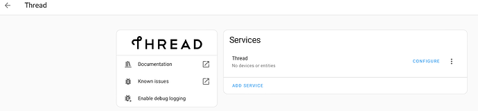

The thread integration is still not showing anything:
