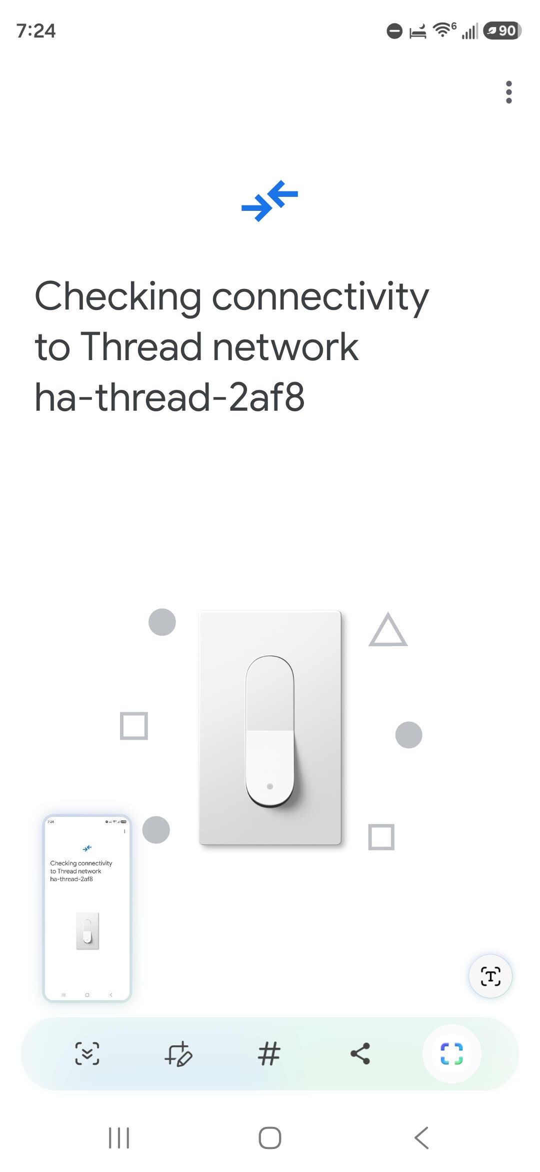

Pairing always gets to this stage and fails with home assistant.
I have the open thread border router and everything setup as far as I know.
