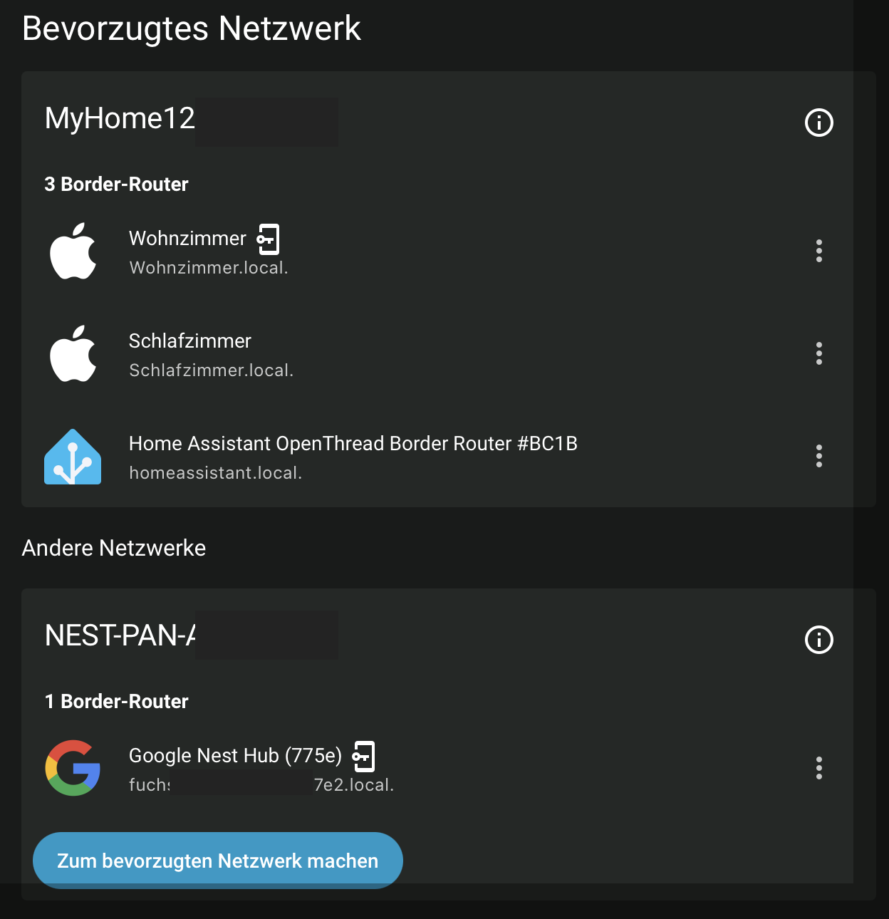

I recently added a ZBT-2 to my installation, hoping that this allows me to merge/combine my Nest Hub Border Router into my preferred network together with my Apple TVs (which are my main border routers for my thread devices).
However, I’m not able to find out how.
Any good advice here?
Edit:
Maybe I’m just on the wrong path. I thought this would be possible because I’m very sure that I’ve seen a lot of Videos or Screenshots where Google Nest Hub and Apple TVs were shown under the same “MyHome …” network. Anyway I cannot find anything about that in the docs.
Sorry, at this time Google/Nest does not appear to let you pick an arbitrary network to join. It appears that, when being initially setup, it may (may!) join a network that has been previously saved to your iCloud Keychain, and if it doesn’t find one, it creates a new one. So one approach is to factory reset the Nest Hub and use an iPhone with iCloud credentials to set it up again, hoping that it finds the MyHome network to use. However unless your Nest Hub is in a part of the house with bad Thread coverage, I’m not certain whether adding a fourth TBR to your existing mesh will make much of a difference, in which case you can just ignore it.
