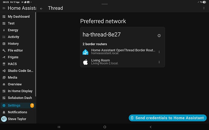

I’ve also got an Apple TV, which as soon as I apply power seems to mess things up. Multiple Thread devices drop off line, mostly affecting the devices which are close to the Apple TV.
If I look in the Thread tab of the Matter Server app, I can see that the affected devices or their neighbours are showing the Apple TV as the “external” connection in the list of neighbours.
If I sit and watch the the preferred network box in the Thread section, the Apple TV will pop up as a Border Router for a few seconds every minute or two. It shows up, then goes away again.
I think that the Apple TV is continually trying to join the preferred network, devices are re-routing to utilise it, then re-routing again when it disappears.

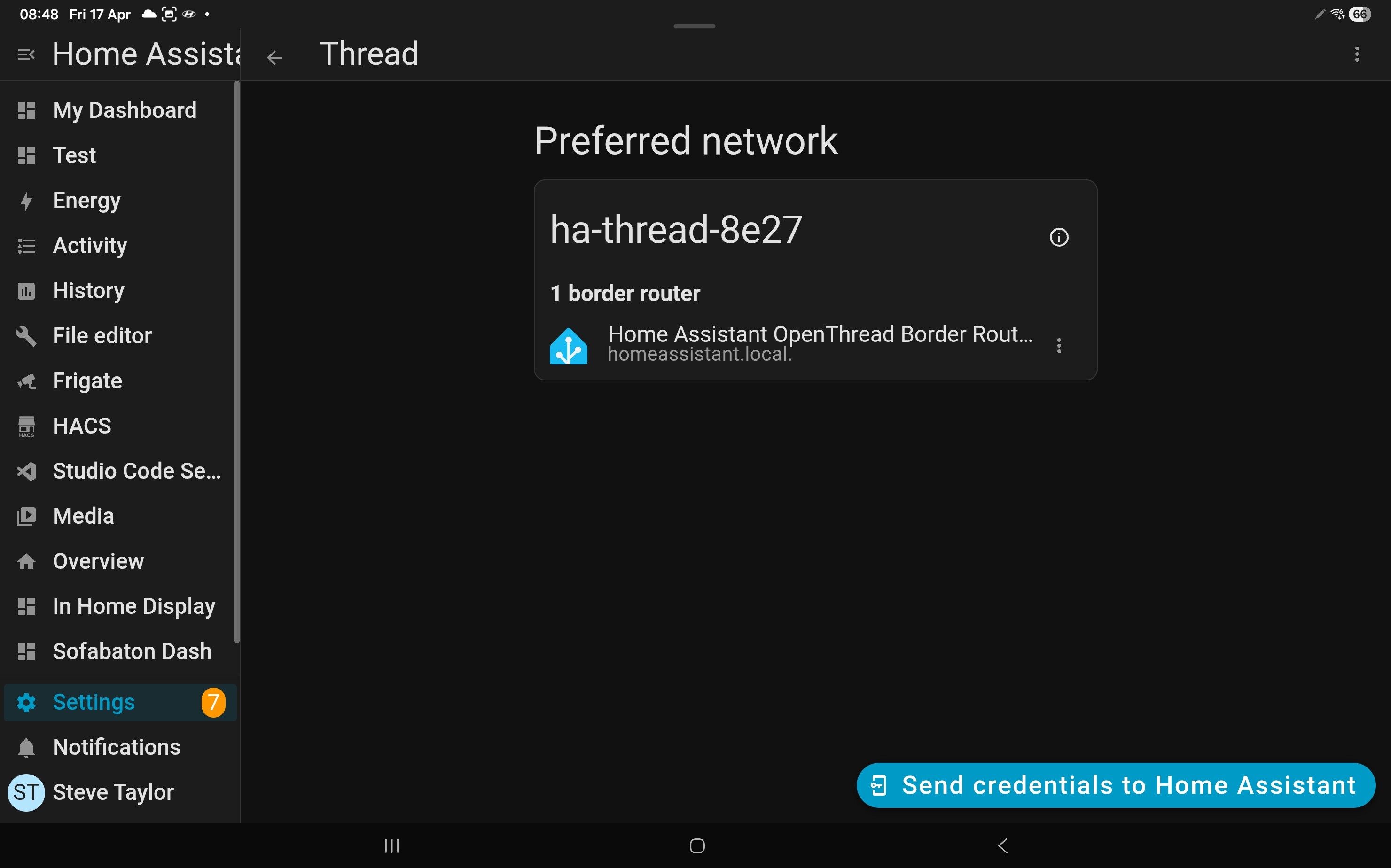

OK, I think I’ve fixed it.
I deleted any “Thread” references in the Apple Keychain, then factory reset the Apple TV.
I also deleted the Credentials on my iPhone’s companion app.
The Apple TV automatically created a new Thread network, but it shows up as a completely separate network in HA. I just need to avoid using my iPhone to add new devices.
Been up and running for 2 hours, no problems
