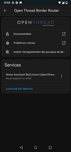

I added mater beta, thread is sea on device with my skyconnect on border router.
I tried add eve motion with matter integration but it failed. It says no border router.
Why it see it in thread but says no border router.
Maybe I have some error in log of plugin border router but process run ok

2024-02-11 17:42:29 core-matter-server chip.-[126] ERROR src/platform/Linux/bluez/ChipDeviceScanner.cpp:173: CHIP Error 0x00000032: Timeout at src/controller/SetUpCodePairer.cpp:324
2024-02-11 17:42:29 core-matter-server chip.BLE[126] ERROR BLE scan error: src/platform/Linux/bluez/ChipDeviceScanner.cpp:173: CHIP Error 0x00000032: Timeout
2024-02-11 17:42:44 core-matter-server matter_server.server.client_handler[126] WARNING [281473585973840] Disconnected: Received invalid JSON: socket.addEventListener(“open”, (event) => {
console.log(“WebSocket is open”);
var message = {
“message_id”: “2”,
“command”: “commission_with_code”,
“args”: {
“code”: "11******
socket.send(JSON.stringify(message));
2024-02-11 17:42:49 core-matter-server chip.CTL[126] ERROR Discovery timed out
2024-02-11 17:42:49 core-matter-server chip.ZCL[126] ERROR Secure Pairing Failed
2024-02-11 17:42:49 core-matter-server matter_server.server.client_handler[126] ERROR [281473348477712] Error handling message: CommandMessage(message_id=‘2’, command=‘commission_with_code’, args={‘code’: ‘11916035719’})
File “/usr/local/lib/python3.11/site-packages/matter_server/server/client_handler.py”, line 193, in _run_handler
result = await result
File “/usr/local/lib/python3.11/site-packages/matter_server/server/device_controller.py”, line 265, in commission_with_code
raise NodeCommissionFailed(
matter_server.common.errors.NodeCommissionFailed: Commission with code failed for node 17.
2024-02-11 17:42:50 core-matter-server chip.DIS[126] ERROR Timeout waiting for mDNS resolution.
2024-02-11 17:47:47 core-matter-server chip.CTL[126] ERROR Commissioning discovery over BLE failed: src/platform/Linux/bluez/ChipDeviceScanner.cpp:173: CHIP Error 0x00000032: Timeout
2024-02-11 17:47:47 core-matter-server chip.-[126] ERROR src/platform/Linux/bluez/ChipDeviceScanner.cpp:173: CHIP Error 0x00000032: Timeout at src/controller/SetUpCodePairer.cpp:324
2024-02-11 17:47:47 core-matter-server chip.BLE[126] ERROR BLE scan error: src/platform/Linux/bluez/ChipDeviceScanner.cpp:173: CHIP Error 0x00000032: Timeout
The current version of the OTBR add-on is completely broken. I’ve started a similar thread a while ago, as well as this issue.
There hasn’t been any traction on that issue or a few similar ones I found. HA describes Thread as “work in progress”, but that may be a bit generous… The only functionality my Thread devices have right now is as expensive paperweights :cry:
Turns out most of this was PEBKAC. I was able to get my setup working with these instructions. With 2.4.6 my thread devices have been stable so far.
Finnaly I try with a raspberry 4. And it works. Maybe my Bluetooth key was not compatible.
My freebox VM is now off less noise.
