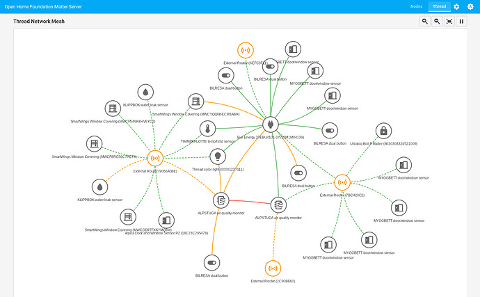

I’ve had a few Matter over Thread devices for a while, and recently I significantly expanded my network thanks to the new IKEA devices. I’ve been using the new OHF Matter(.js) Server available as an option in the current Matter Server App, along with the OpenThread Border Router App. Things were very good (the new Matter server is looking great!), but I was still running into frustrating issues where Thread devices would just go offline for a while with no seeming rhyme or reason.
I tried moving devices around, re-commissioning problematic devices, reviewing my UniFi configuration to ensure that things were configured the right way, and none of it seemed to actually do any good.
