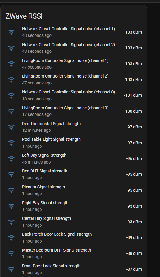

My zbt-2 and green are as far to the west side of the house as you can get. They’re on the bottom shelf of a tv cabinet nearest the west wall. Its kind of my house data center; cable modem, router, ha green, zbt-2 and yolink hub all right there and media/gaming controllers on top of them and the tv.
For thread I have 2 innovelli white fan swtiches in bathrooms almost as far east as you can go. I know from using my router that 2.4ghz wifi makes it there, as a comparison. Both switches work but the network diagram in the matter app/addon had them as red, low quality signal.
Today Iinstalled an eve outlet, which turns out to be a fantasic thread mesh router. I put it on a pigtail power cord and tested it in several candidate outlet locations. Found one where all endpoints improved, installed it and it greatly improved the mesh. Now I can implement thread lighting products without problems, once some come out with thread spec scenes and work the way I want.
Maybe I should order one and try. I’m using a ZST39 LR at each end of the house. When I got the smart wings shades, I had a LOT of issues, they sent more controllers, I moved antenna, changed firmware, and finally got them more or less stable, but I still have a lot of devices very close to the reported noise floor.
All these items work fine, though, now. But my 60’s vintage house is pretty hard on RF signals. My 2.4g iot stuff work, but I’ve put in 5 separate AP’s around the house to keep things (especially ESP32-C6’s with the built in antenna) functional. Much of the house walls inside are brick, others are 2 layers of wall board (one of them vintage 60’s and really sheet “rock”).
Maybe what I should do is get one of the zbt2’s and find a place to put it and see how it does instead, though moving each device is rather tedious. But I don’t really have a good spot for “central” with ethernet.
