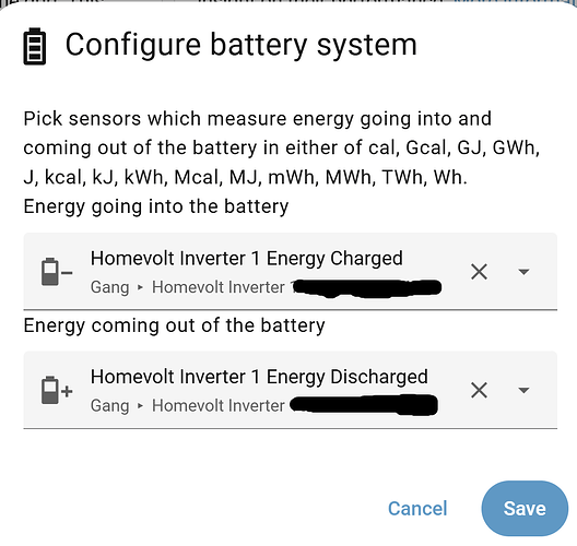

I’ve setup this and the data is in HA.

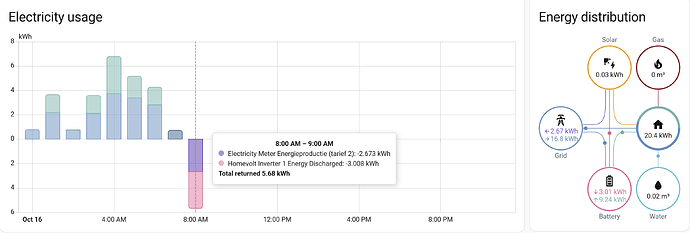

I have a small problem with using it on energy dashboard.

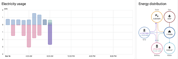

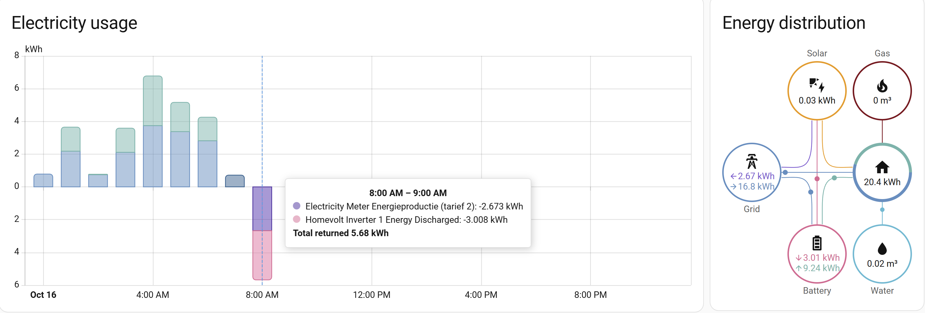

When changing the sensors from place I see difference but they have both problems. The one with the little bit green on 8am shows the correct value for that time. The night is wrong. When swapping the values the night is correct and 8am is incorrect. How to solve this?
correct 8am incorrect night
incorrect 8am correct night

When looking at HA demo dashboard you see the same
So maybe this is the expected way? Both values of the battery are total increasing positive. So there is no issue in the integration.
