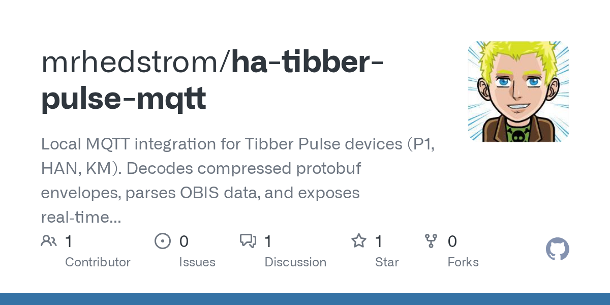

I want to share Tibber Pulse MQTT, a HACS integration for Home Assistant that provides fully local access to Tibber Pulse data via MQTT, with optional forwarding to Tibber Cloud (AWS IoT).

GitHub repository:
