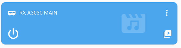

I try to create a card with a device in a tile.
This device displays the wrong state.
type: tile
entity: media_player.rx_a3030_main

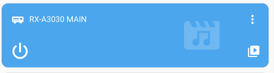

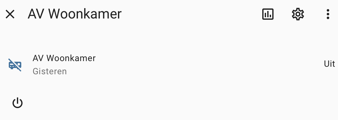

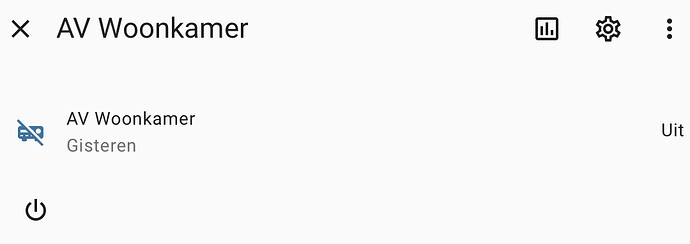

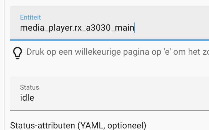

This is what my receiver shows for off:
and on:
So HA is not forcing to do anything strange.

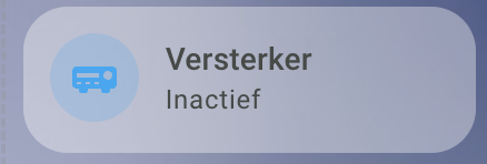

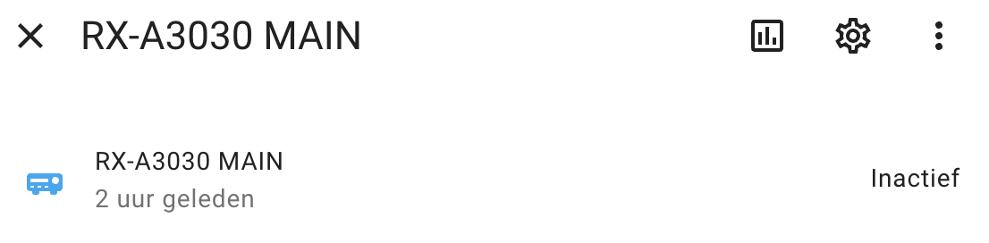

No, as you can see on my image, the status is idle. and HA will present it as “inactive”
and it will present it as “off” (uit in dutch) when it is turned off.
Inactive is not off. It is On but presented as Inactive.
And i want it to present the state “on” if that is possible.
