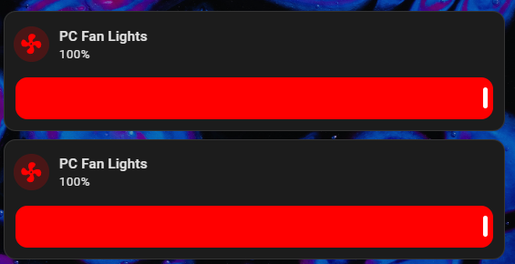

Untitled video - Made with Clipchamp

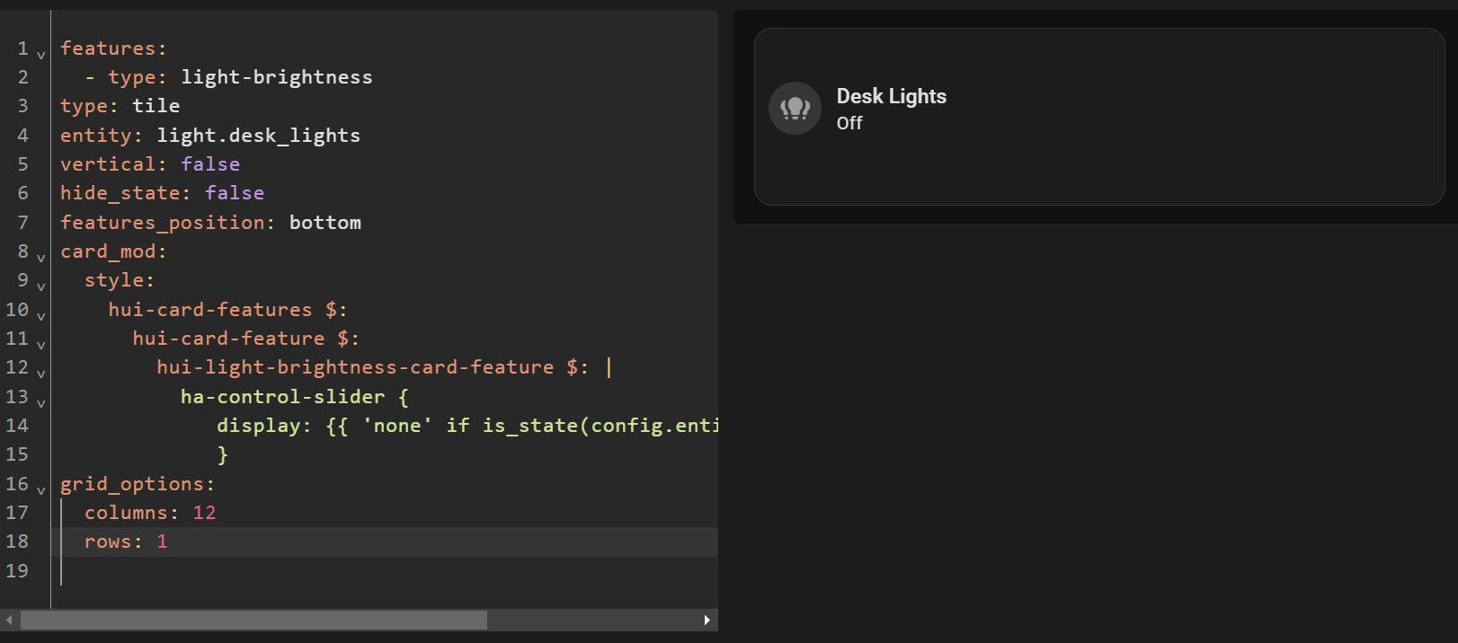

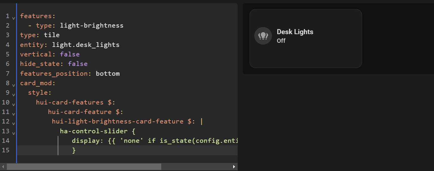

When I add a card with that exact code just the entity replaced to a valid entity in my home, the card will always take up 2 rows no matter what I do. Same if I manually define column and row values as well:
Code exactly as is, only entity updated:
With Column and Row defined:

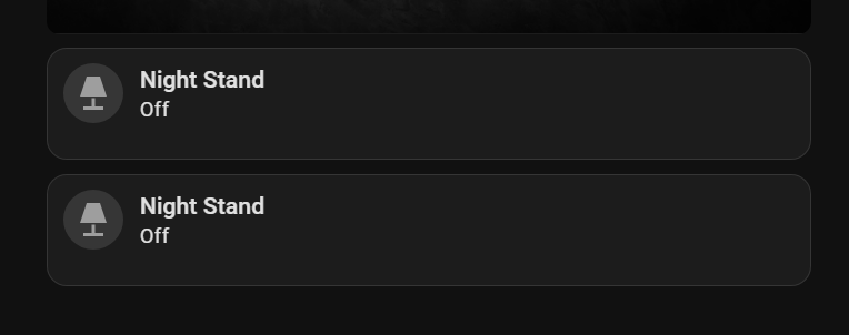

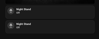

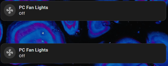

Doesn’t really affect me now, but only issue I run into with this specifically now is that the actual card frame itself is still the full 2 row height even though it’s only displaying 1 row height, so you can’t place cards directly on top of each other without a gap while they’re off:

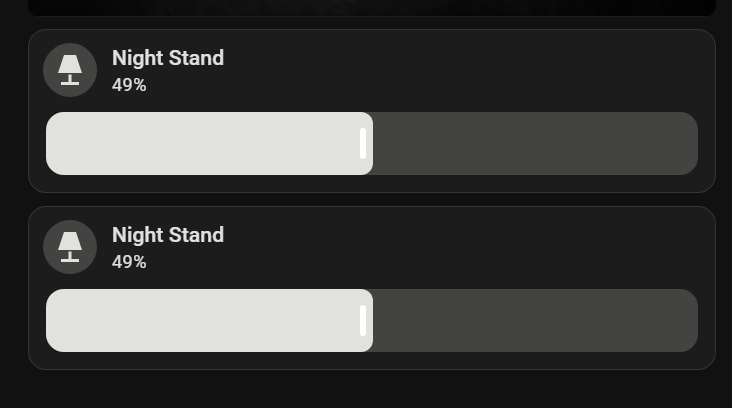

If you place the cards in a vertical-stack, that issue will go away. It also doesn’t require the quoted additional card mod code above.
type: vertical-stack
cards:
  - features:
      - type: light-brightness
    type: tile
    entity: light.night_stand
    features_position: bottom
    vertical: false
    card_mod:
      style:
        hui-card-features $:
          hui-card-feature $:
            hui-light-brightness-card-feature $: |
              ha-control-slider {
                 display: {{ 'none' if is_state(config.entity, 'off') else 'block' }}
  - features:
    type: tile
    vertical: false
    card_mod:
      style:
          hui-card-feature $:
              ha-control-slider {
grid_options:
  columns: 12
  rows: auto
OFF
ON
