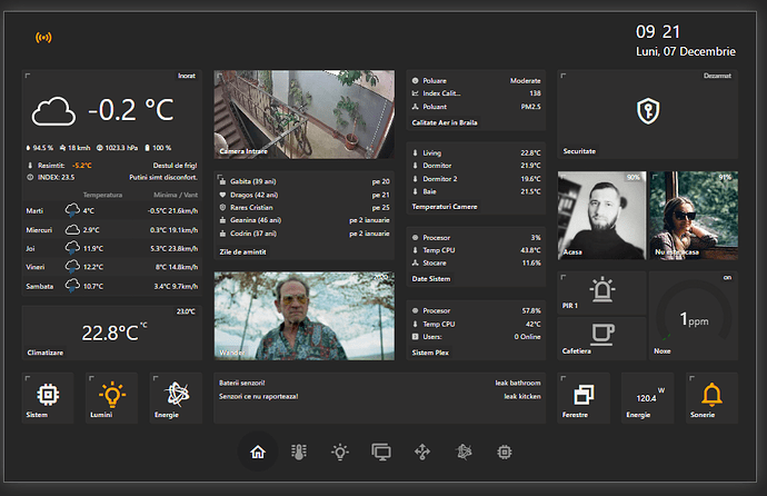

hope you guys like my tileboard (not finished, and sorry, it’s in romanian language)
