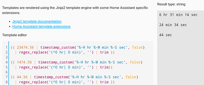

In case anyone else is looking for a concise way of displaying seconds as hours/minutes/seconds (and suppressing hours or minutes if they're zero):
{{ states('sensor.custom_print_time_left') | int(0)
  | timestamp_custom('%-H hr %-M min %-S sec', false)
  | regex_replace('(^0 hr| 0 min)', '') | trim }}
The pattern within timestamp_custom is easy to change if you need a different time format.
Reference: strftime
