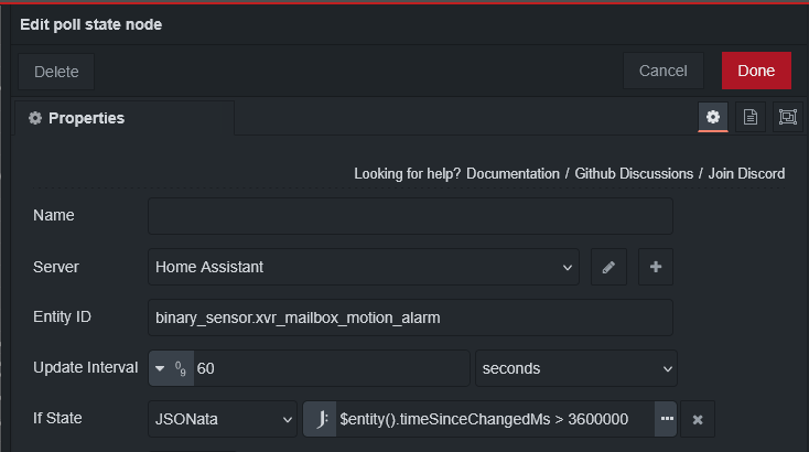

You can also use jsonata and do the checking in the poll node. Time is in milliseconds so, for example, an hour would be 3600000.
$entity().timeSinceChangedMs > 3600000

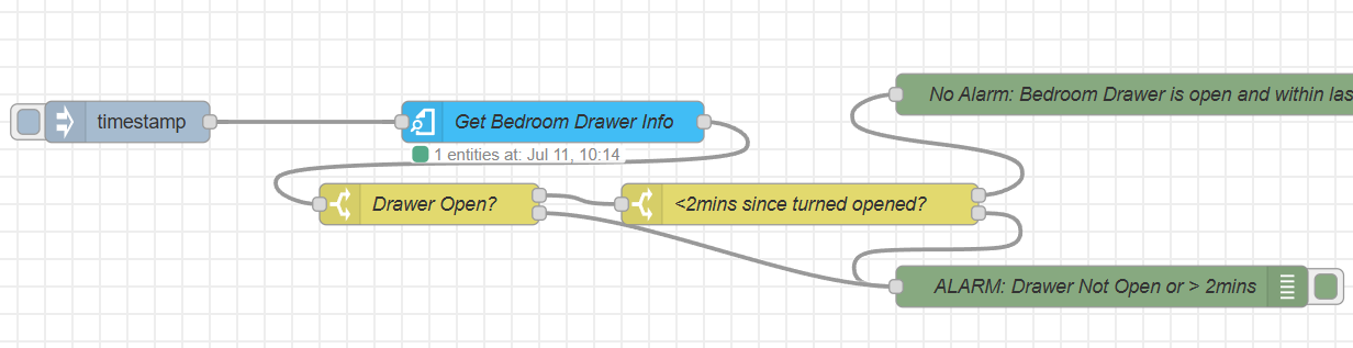

Sorry to reopen this thread, but I’m trying to do something similar and struggling

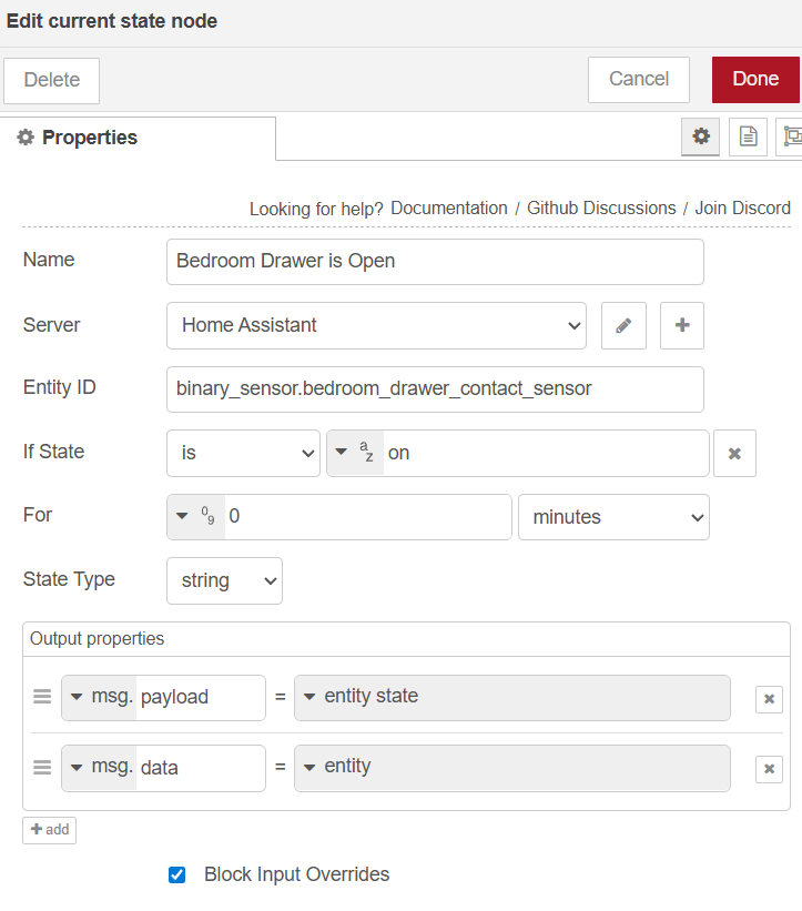

I have a current state node below which checks if a drawer is open
What I want to know is if the state changed to open in the past 2 minutes… i.e. if at the time this node is checked it has been left open for longer than 2 minutes it will give one result, and if it became that state within 2 minutes it would give another result…
I feel this should be simple - i know it is if I want to know that it’s been open for 2 mins as I can do it in the properties as is - but I want to know if the timeSinceChange is <2mins
Can someone advise how I might do that in this flow??
[{"id":"3b2c035eeb7bce4c","type":"server-state-changed","z":"dfe30d90959988bc","name":"Bedroom Bottom Left Window","server":"3aa13fed.bf745","version":6,"outputs":2,"exposeAsEntityConfig":"","entities":{"entity":["binary_sensor.bedroom_window_bottom_left_contact_sensor_contact"],"substring":[],"regex":[]},"outputInitially":false,"stateType":"str","ifState":"on","ifStateType":"str","ifStateOperator":"is","outputOnlyOnStateChange":true,"for":"0","forType":"num","forUnits":"minutes","ignorePrevStateNull":true,"ignorePrevStateUnknown":true,"ignorePrevStateUnavailable":true,"ignoreCurrentStateUnknown":true,"ignoreCurrentStateUnavailable":true,"outputProperties":[{"property":"payload","propertyType":"msg","value":"","valueType":"entityState"},{"property":"data","propertyType":"msg","value":"","valueType":"eventData"},{"property":"topic","propertyType":"msg","value":"","valueType":"triggerId"}],"x":160,"y":1020,"wires":[["a738ccdc5e567ced","4fe5d44ef7163671"],["a738ccdc5e567ced","4fe5d44ef7163671"]]},{"id":"4fe5d44ef7163671","type":"api-current-state","z":"dfe30d90959988bc","name":"Bedroom Drawer is Open","server":"3aa13fed.bf745","version":3,"outputs":2,"halt_if":"on","halt_if_type":"str","halt_if_compare":"is","entity_id":"binary_sensor.bedroom_drawer_contact_sensor","state_type":"str","blockInputOverrides":true,"outputProperties":[{"property":"payload","propertyType":"msg","value":"","valueType":"entityState"},{"property":"data","propertyType":"msg","value":"","valueType":"entity"}],"for":"0","forType":"num","forUnits":"minutes","override_topic":false,"state_location":"payload","override_payload":"msg","entity_location":"data","override_data":"msg","x":550,"y":920,"wires":[["e3528021cb5f8667"],["20d9a8df8398fc8f"]]},{"id":"20d9a8df8398fc8f","type":"debug","z":"dfe30d90959988bc","name":"No Alarm: Bedroom Drawer is open","active":true,"tosidebar":true,"console":false,"tostatus":false,"complete":"payload","targetType":"msg","statusVal":"","statusType":"auto","x":1020,"y":920,"wires":[]},{"id":"3aa13fed.bf745","type":"server","name":"Home Assistant","version":5,"addon":true,"rejectUnauthorizedCerts":true,"ha_boolean":"y|yes|true|on|home|open","connectionDelay":true,"cacheJson":true,"heartbeat":false,"heartbeatInterval":30,"areaSelector":"friendlyName","deviceSelector":"friendlyName","entitySelector":"friendlyName","statusSeparator":"at: ","statusYear":"hidden","statusMonth":"short","statusDay":"numeric","statusHourCycle":"h23","statusTimeFormat":"h:m","enableGlobalContextStore":true}]
EDIT: Answering my own question - found this solution in a reddit thread and seems to be working:
[{"id":"ba0faeb3.d854f","type":"ha-get-entities","z":"dfe30d90959988bc","name":"Get Bedroom Drawer Info","server":"3aa13fed.bf745","version":1,"rules":[{"condition":"state_object","property":"entity_id","logic":"is","value":"binary_sensor.bedroom_drawer_contact_sensor","valueType":"str"}],"outputType":"array","outputEmptyResults":false,"outputLocationType":"msg","outputLocation":"payload","outputResultsCount":1,"x":450,"y":1980,"wires":[["41727ce9.15ee34"]]},{"id":"41727ce9.15ee34","type":"switch","z":"dfe30d90959988bc","name":"Drawer Open?","property":"payload[0].state","propertyType":"msg","rules":[{"t":"eq","v":"on","vt":"str"},{"t":"eq","v":"off","vt":"str"}],"checkall":"true","repair":false,"outputs":2,"x":360,"y":2040,"wires":[["c14a641f.1ac488"],["a899c1a861915553"]]},{"id":"c14a641f.1ac488","type":"switch","z":"dfe30d90959988bc","name":"<2mins since turned opened?","property":"payload[0].timeSinceChangedMs","propertyType":"msg","rules":[{"t":"lt","v":"120000","vt":"str"},{"t":"else"}],"checkall":"true","repair":false,"outputs":2,"x":630,"y":2040,"wires":[["2fc65d5d91621316"],["a899c1a861915553"]]},{"id":"8d991fad1637caf2","type":"inject","z":"dfe30d90959988bc","name":"","props":[{"p":"payload"},{"p":"topic","vt":"str"}],"repeat":"","crontab":"","once":false,"onceDelay":0.1,"topic":"","payload":"","payloadType":"date","x":140,"y":1980,"wires":[["ba0faeb3.d854f"]]},{"id":"a899c1a861915553","type":"debug","z":"dfe30d90959988bc","name":"ALARM: Drawer Not Open or > 2mins","active":true,"tosidebar":true,"console":false,"tostatus":false,"complete":"payload","targetType":"msg","statusVal":"","statusType":"auto","x":850,"y":2100,"wires":[]},{"id":"3aa13fed.bf745","type":"server","name":"Home Assistant","version":5,"addon":true,"rejectUnauthorizedCerts":true,"ha_boolean":"y|yes|true|on|home|open","connectionDelay":true,"cacheJson":true,"heartbeat":false,"heartbeatInterval":30,"areaSelector":"friendlyName","deviceSelector":"friendlyName","entitySelector":"friendlyName","statusSeparator":"at: ","statusYear":"hidden","statusMonth":"short","statusDay":"numeric","statusHourCycle":"h23","statusTimeFormat":"h:m","enableGlobalContextStore":true}]

To use it in a current state node.
