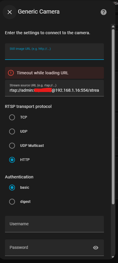

Timeout while loading URL for WebRTC camera
I have the dockerwyzebridge add on. It provides me a WebRTC link to my camera. Putting the URL into my web browser produces the feed. Putting same URL into generic camera field gives me an error.

I’ve the same problem with a EZVIZ Cam Model CTQ2C.
Live streming work fine with a VLC video player but configuration on HA returns me timeout errors.

try by adding the following configuration in the configuration.yaml
camera:
  - platform: generic
    stream_source: rtsp://utente:password@ip:porta/stream
    still_image_url: http://ip/snapshot.jpg
    verify_ssl: false
    timeout: 30
change the value of “name”, “stream_source” and “still_image_url”
Regarding the last value: not yet clear how to load an image in local, but WIP :slight_smile:
comeing back to your problem: some camera takes longer then 10 second to load, by adding timeout: 30 we are going to increase the timeout.
