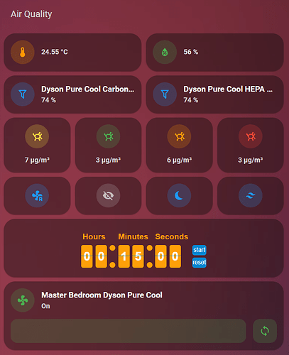

I would like to use timers (the value of the duration) as input for my lights transition. As such, I can have visual feedback with one of the multiple cards in the GUI of the time my Automation will still be running.
The challenge is that the timer.duration has the format H:MM:SS while the Lights Transition requires a value in seconds (integer).
