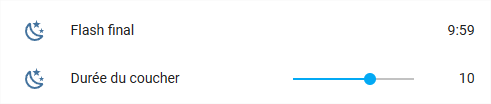

I’ve a problem with template using number helper. When I use simple template such as:
service: timer. Start
  duration: "{{states('input_number.time_duration')}}"
  entity_id: timer.timer_ch1
Timer starts but counting only as second. My question: is how set as minutes. In my solution I cannot use time - helper because it use HH:MM format.
My problem looks like below:
2023-06-19 16_04_43-Clipboard
Please support me, I’m not advanced HA user :slight_smile:
Thanks in advance!
