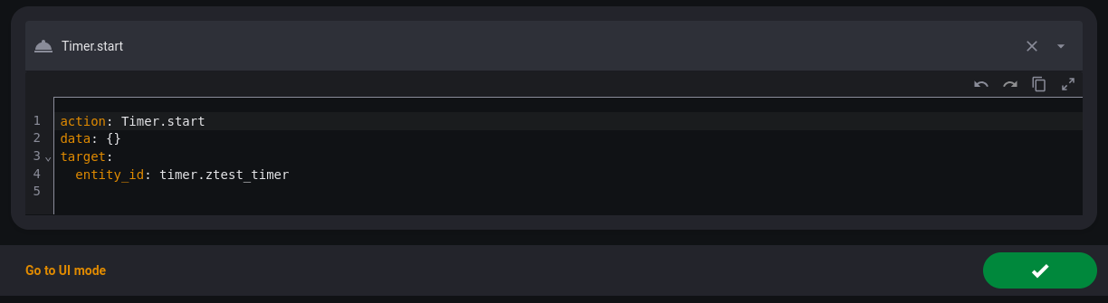

The action with capital T is accepted in the Actions tool, and the timer starts.

This is what is displayed in the Automation Editor in Visual mode.
It shows Timer: Start
If you switch the Automation Editor to YAML mode, Timer: Start is displayed like this:
It shows timer.start
So where exactly did you see Timer.start in the GUI?
