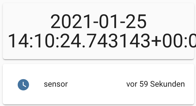

How would I display a time stamp value as a relative value (5 minutes ago) instead of the absolute time stamp like it is done in the entities–card?
Preferred would be a solution just changing the display without creating a new template sensor.

You can’t without making a template sensor or using a Lovelace card that accepts templates. The unfortunate drawback to timestamp sensors is that the underlying relative time code isn’t built into all the cards yet.

Timestamp sensors have existed for a long time. Prior to this post even. The reason his sensor isn’t showing up as relative time is because his sensor isn’t listed as a device_class: timestamp
