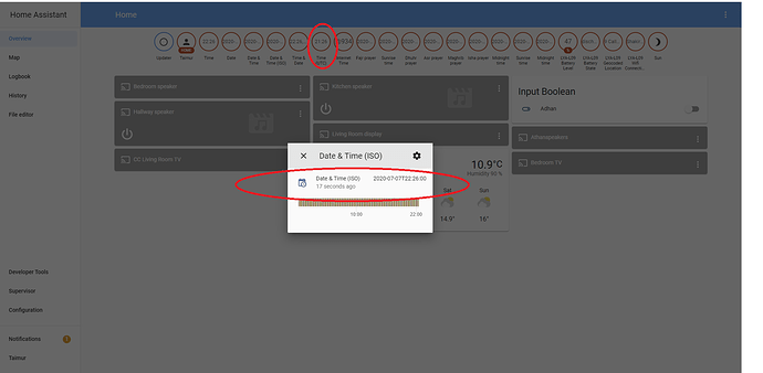

So this this the time
the correct time for my timezone is displayed in Front end of HA with UTC which I know is always different for the backend.

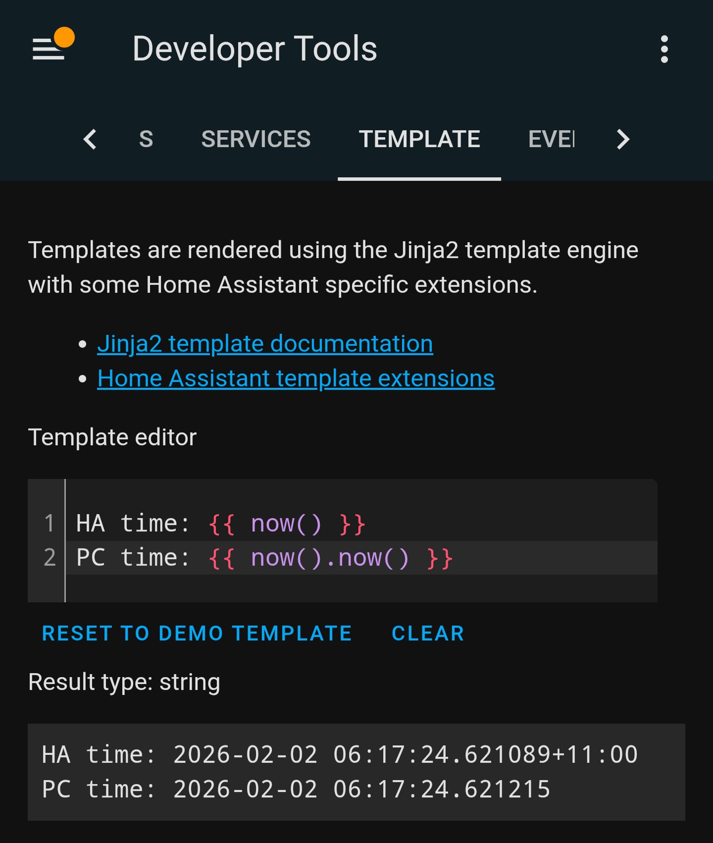

All my time automations were suddenly using utc time instead of local time, when I moved from a PC install to raspberry pi 4.
I set my user timezone correctly but still they executed using utc time.

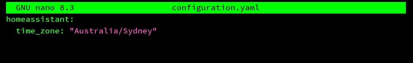

To fix it I found I had to specify a timezone in configuration.yaml:
Otherwise these two times would differ:
This wasn’t a problem when running on my PC but became one when running on a raspberry pi 4.
I hope that helps!
