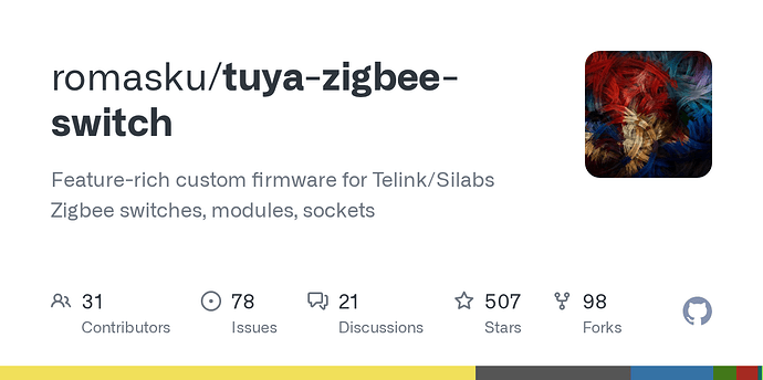

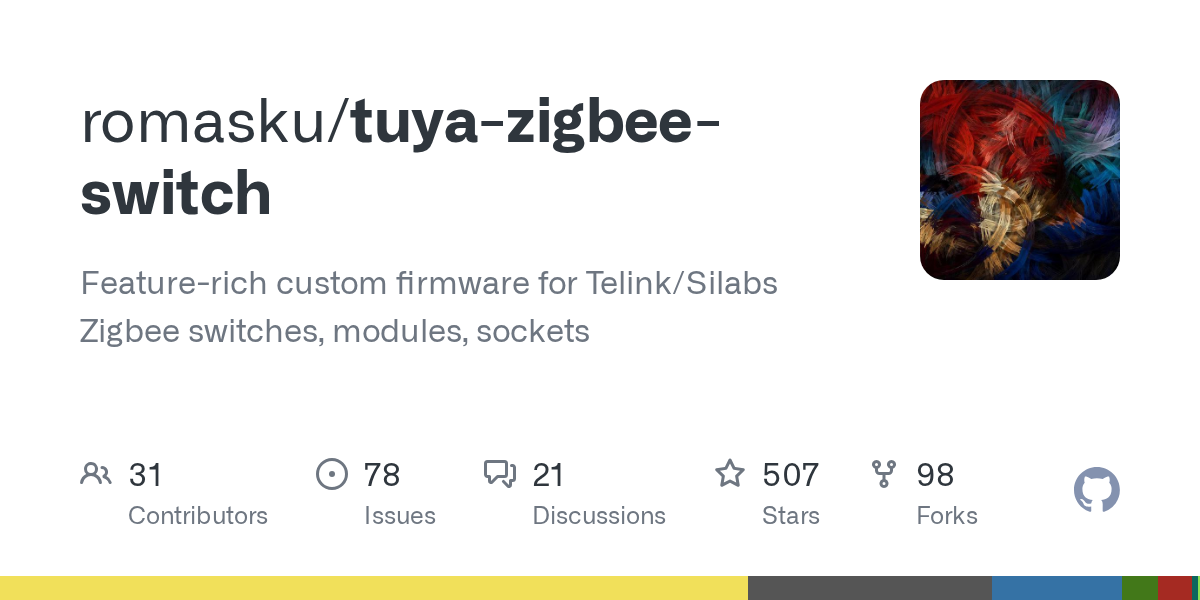

Another option is tuya switches, you can still install custom firmware to enable detach relay, binding and other features

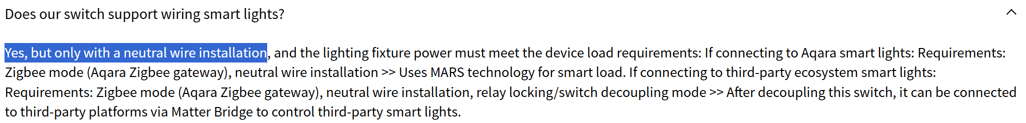

The problem isn’t the lack of availability of no-neutral switches which support decoupled mode. It’s due to the fact that they don’t pull parasite power from the bulbs when using no neutral + decoupled mode with smart bulbs.
There are multiple forum posts about this, and suppliers like Aqara explicitly warn you that you need to wire in a neutral when using with smart bulbs:
Frankly, if Aqara haven’t figured this out, I doubt Tuya have (even with that custom firmware). I’m happy to be proven wrong, but easiest way out is to simply pull a neutral to the switch location.
