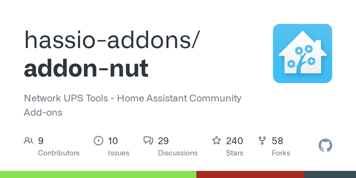

Thanks for all the suggestions. I plan to do HAOS. It’s how it’s running now in VMWare. Any suggestions on how to identify and relink all the USB devices? I ran NUT on my host PC, how do I reestablish that connection without Windows? I presume MQTT will continue to work since it’s layer 3?

with haos, you can leverage addons
